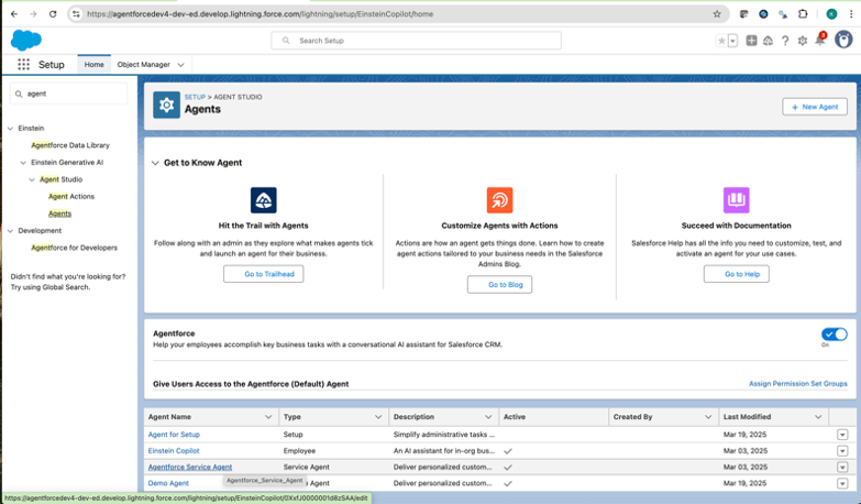

Salesforce AgentForce

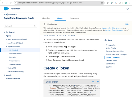

To register an agent that is built within Salesforce Agent Force as an external agent:
  1. Follow the Getting Started Guide for the Agent API. For more information, see the Getting Started Guide.
  1. On the Create a token page, the following information applies to all Salesforce agents within the instance:
    • api_url: Always set to https://api.salesforce.com/einstein/ai-agent/v1.
    • auth_config.token: Use the CONSUMER_SECRET provided in the guide.
    • chat_params:
      • client_id: Use the CONSUMER_KEY.
      • domain_url: Use the DOMAIN_URL.
      • Optionally, specify a list of display types to pass to Orchestrate as a comma-separated string.
  2. Provide well-crafted descriptions for your agents. These descriptions are used by supervisor agents to determine how to route user requests. For more information, see Writing descriptions for agents.
  3. Lastly, under chat_params you need to specify your agent_id. This can be found by hovering over one of your agents and either right-clicking and copying the URL, or by manually writing it based on hover text. In the following example, the agent_id is 0XxfJ0000001d8zSAA.

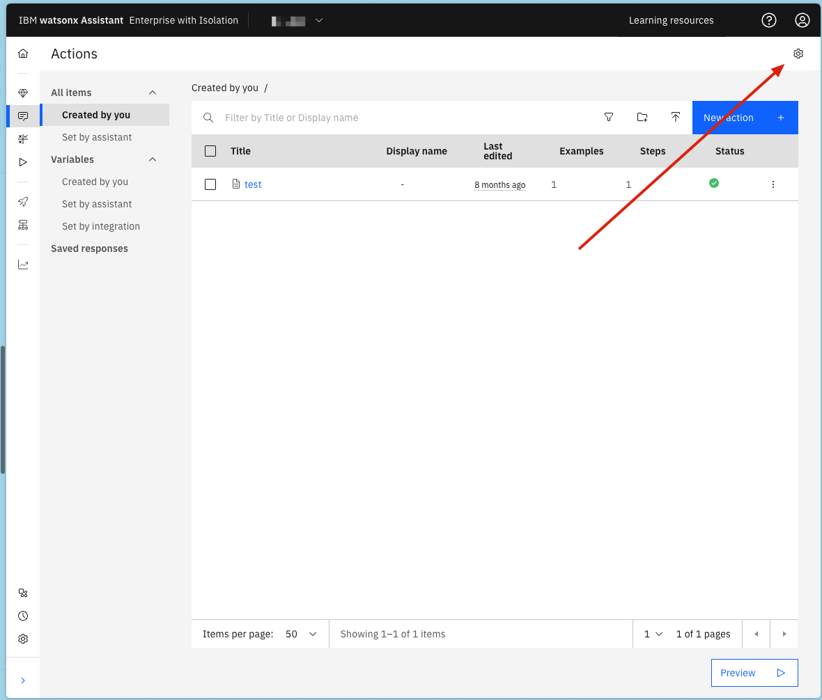

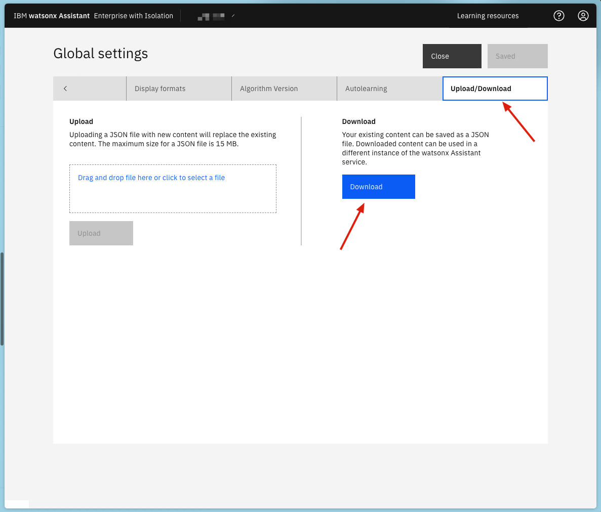

To retrieve your assistant ID:
  1. Navigate to the settings on the actions page and open the settings.

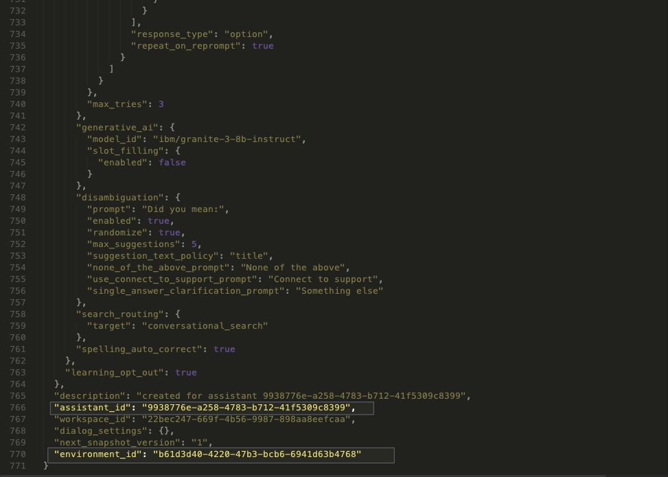

  1. On the farthest right tab, select Upload/Download, and click the Download button.
  1. Locate your environment_id and assistant_id in the output JSON.
