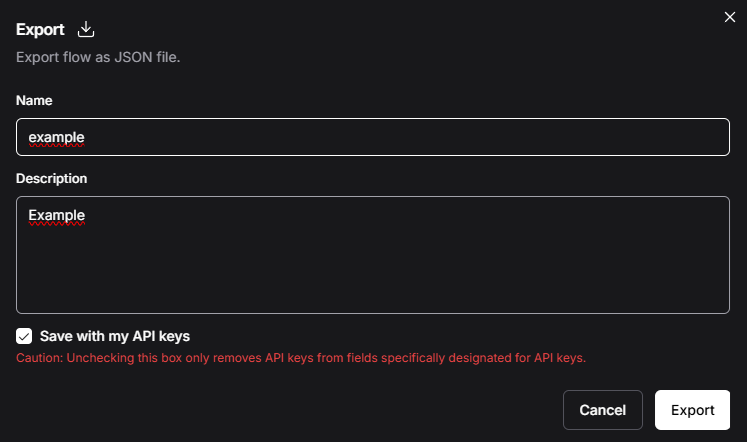

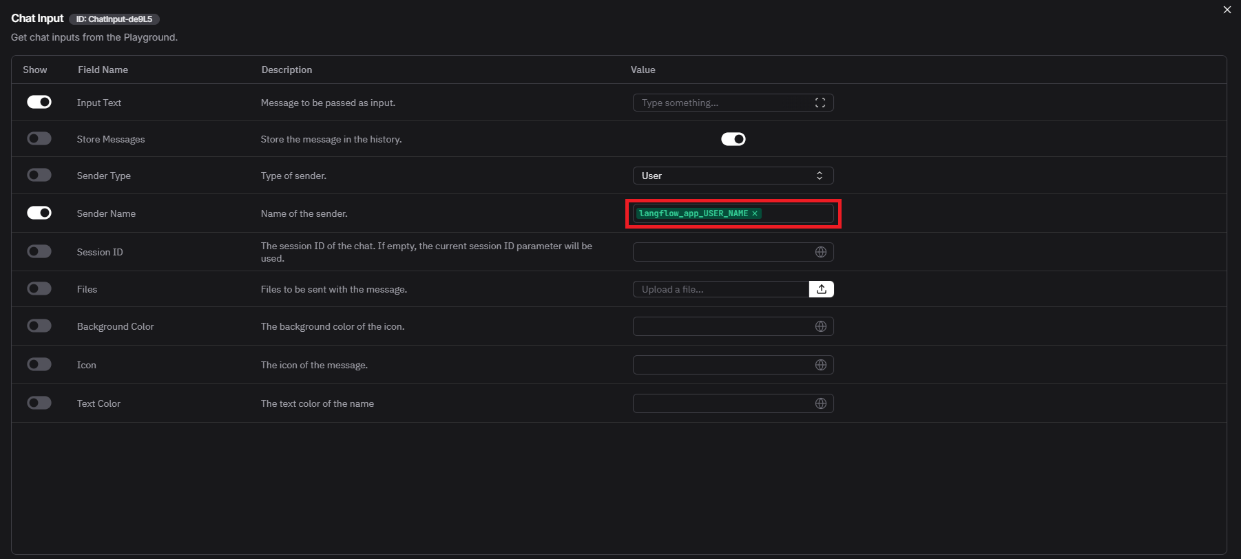

Use the Langflow visual editor to build Langflow tools. It helps you quickly turn ideas into powerful, real-world solutions. If you’re using watsonx Orchestrate Developer Edition, enable Langflow by starting it with the --with-langflow flag. If you’re not using the Developer Edition, install Langflow manually. For more information, see Install Langflow in the Langflow documentation. Once you have access to the Langflow editor, start building your Langflow flow. The editor includes several pre-built templates that you can use as-is or customize to fit your needs. For more information, see Use the visual editor in the Langflow documentation. When building Langflow flow for watsonx Orchestrate, configure dynamic values as global variables. Then, bind these variables to watsonx Orchestrate connections to maintain their dynamic behavior. For more information, see Binding global variables to connections.
