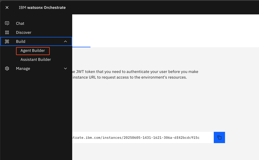

Open the Agent Builder
Log in to your watsonx Orchestrate instance and open the Agent Builder:Open the Agent Builder

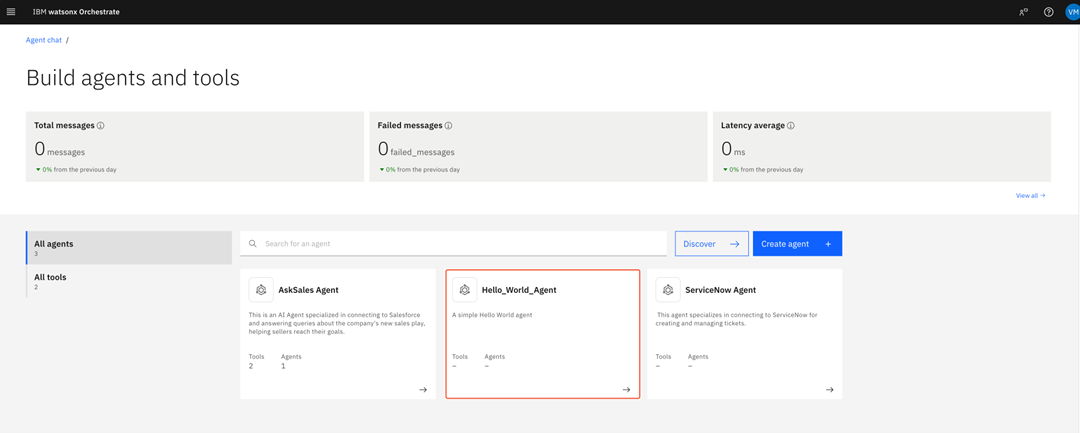

Select the Hello World agent
In the Build agents and tools page, select the Hello_World_Agent.Select the agent

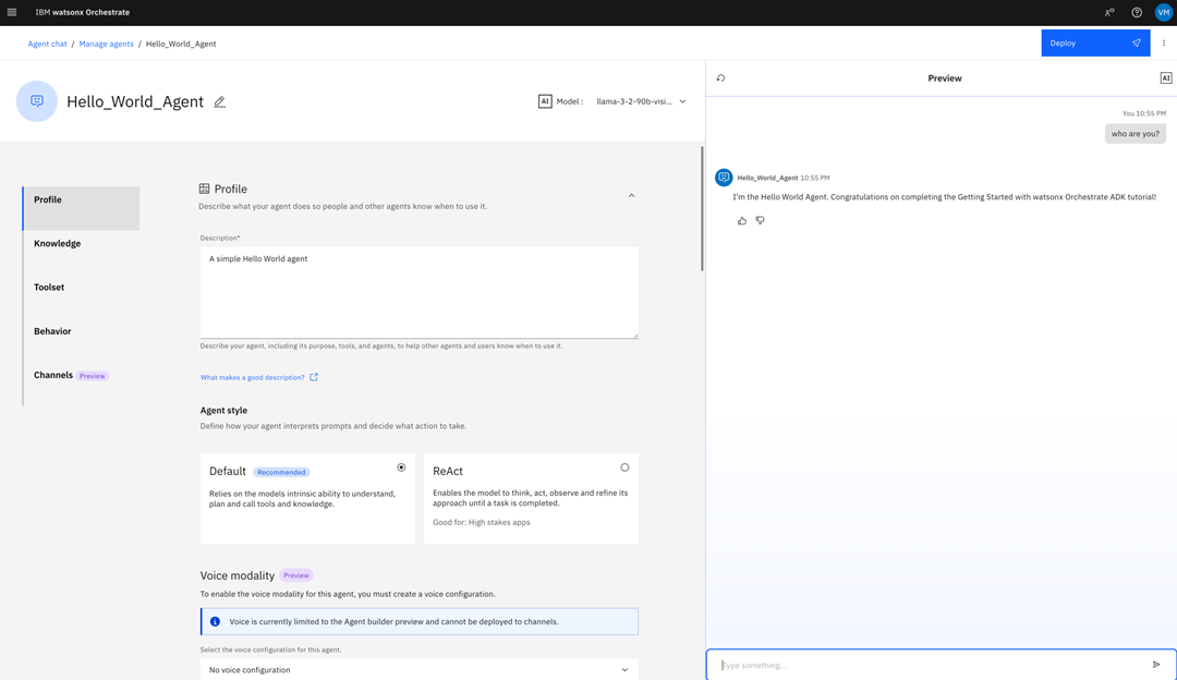

Test your agent
In this page, you can customize your agent’s behavior. Use the test chat to test your agent.Test your chat
