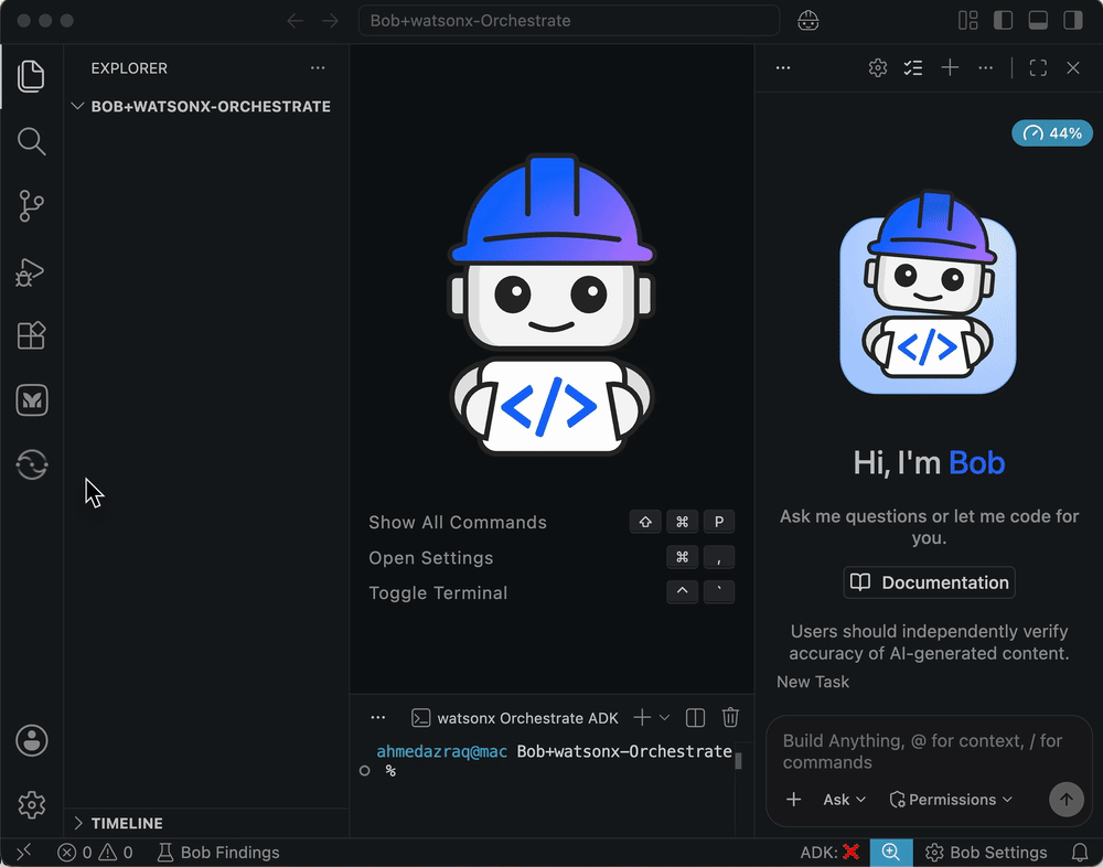

  <Step title=" Click Initialize Workspace">
    <Frame>
      <img src="https://ibm.github.io/ibm-watsonx-orchestrate-adk/docs/assets/init-workspace-Bob-skills-mcp.gif" />
    </Frame>
  </Step>
</Steps>
## Automated Workspace Setup
Clicking "Initialize Workspace" handles the entire setup automatically:
* Environment check: Detects an existing healthy environment and skips redundant work. Corrupted virtual environments are cleaned up automatically.
* \*\*Python and ADK setup: Installs `uv` if absent (with your consent), creates a Python 3.12 virtual environment, then installs or upgrades the ADK.
* MCP servers: Detects your IDE (Bob, Cursor, or VS Code Copilot) and configures two MCP servers automatically. Use the **Install MCP Servers** and **Update MCP Servers** commands to re-run this step at any time.
  * watsonx-orchestrate-adk: manage agents, tools, toolkits, knowledge bases, connections, models, and channels on your live watsonx Orchestrate environment.
  * watsonx-orchestrate-adk-docs: searchable ADK reference docs, guides, and API specs directly in your editor.
* Environment activation: Activates your local ADK environment or connects to a SaaS environment automatically. A single API key prompt is shown only when connecting to a remote cluster.
### Initialize Workspace on IBM Bob
In Bob IDE, "Initialize Workspace" runs all 4 steps plus a fifth step exclusive to Bob to load a curated set of watsonx Orchestrate skills. The skills cover the full development lifecycle: from solution architecture to agent implementation to documentation.
Once the workspace is ready, a context is pre-loaded in the Bob chat. Hit **Send Message** to load your skills and start building.
